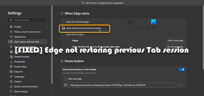

2] Check Edge setting
To make Edge browser open with all the previous tabs opened:
- Open Edge, and click on the three-dot on the top left
- Then click Settings
- Switch on Startup, and select the radio button which says — Continue where you left off.
- Exit.
The next time you launch Edge, it will work as expected.

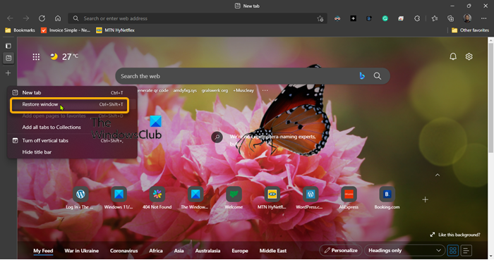

3] Use the Restore window option
If when your session closed abruptly due to one or another reason, and when you relaunch Edge, the browser opens a new window with no tabs showing, you can right-click on a blank area on the Tabs bar and select Restore window – this will pop out the Edge window with all your previous tab session. You can now close the new window without the tabs that opened earlier.

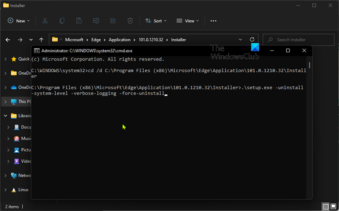

4] Uninstall and Reinstall Edge
If repair or reset failed to resolve the issue in hand, which in most cases, either of the procedure will resolve just about any Edge problems and issues; then you can uninstall and reinstall Edge on your Windows 11/10 PC.
To uninstall Edge browser on Windows 11/10, do the following
- Press Windows key + E to open File Explorer.
- Navigate to the directory path below:
C:\Program Files (x86)\Microsoft\Edge\Application
- At the location, double-click on the folder with the browser version number.
- Next, double-click the Installer folder.
- Now, to copy the location from the File Explorer address bar, press Alt+D, then press CTRL+C.
- Next, open Command Prompt in admin mode.
- In CMD prompt, type the command below and hit Enter to navigate to the folder containing the setup.exe file for Edge browser. Substitute the <Location> placeholder with the path copied from File Explorer address bar.
cd /d <Location>
- Now, copy and paste the command below and hit Enter to force-uninstall Edge on your device:
.\setup.exe -uninstall -system-level -verbose-logging -force-uninstall
- When done you can exit File Explorer and CMD prompt.
Alternatively, copy and paste the command below in the elevated CMD prompt and hit Enter:
cd %PROGRAMFILES(X86)%\Microsoft\Edge\Application\9*\Installer
Similarly, to achieve the same outcome, you can copy your Edge version from the browser About page by clicking the Settings and more menu icon > Help and feedback > About Microsoft Edge. Then execute the following command in the elevated CMD prompt. Replace the <YourEdgeVersion> placeholder with the version number you copied previously.
cd %PROGRAMFILES(X86)%\Microsoft\Edge\Application\<YourEdgeVersion>\Installer
Once the command executes, copy and paste the following command and hit Enter:
setup.exe –uninstall –force-uninstall –system-level
To reinstall Edge on your device, simply download Edge’s latest version from the official page, then run the setup file and follow the on-screen directions to complete the installation.

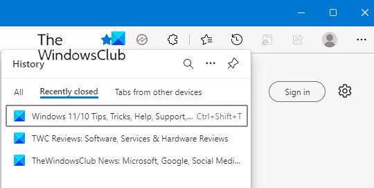

Restore pages prompt does not appear; How do I reopen all the closed tabs on Edge?
If the Restore tabs prompt does not appear, then to reopen all the closed tabs on Edge, do the following:
- Press Ctrl+H to open History
- Click on the Recently closed section
- You will see all the recently closed tabs and web pages.
- Press Ctrl+Shift+T to restore them.
