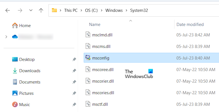

If none of the above fixes worked, restore your system to the previous working state. To perform System Restore, exit Safe Mode and start your system in normal mode. To exit Safe Mode, you have to use MSConfig. But if your keyboard is not working, you cannot launch MSConfig by typing in Windows Search. In this case, go to the following location and launch MSConfig by double-clicking on the executable file.
C:\Windows\System32
