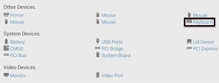

1] Run Dell SupportAssist
First of all, we need to make use of the Dell SupportAssist utility. It is free software that can check what’s wrong with your computer and find the correct remedy. Follow the steps mentioned below to run it.
- Open Dell SupportAssist if it’s already installed on your computer; but if it’s not, download the utility from dell.com.
- Go to the Troubleshooting tab and click on I want to check a specific piece of hardware.
- In Other devices, go to Keyboard.
- Finally, follow the on-screen instructions to complete the process.
This should do the job for you.

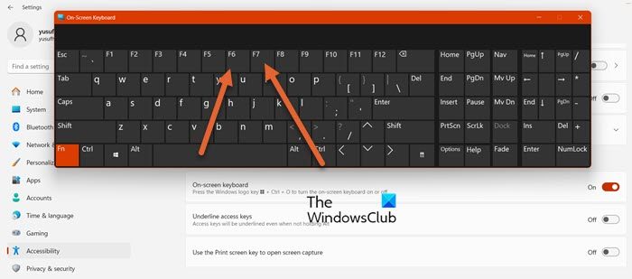

To unlock your ACER Laptop Keyboard, you need to hit Fn + F6 or F7 keys and then check if that works. If you don’t have an external keyboard to do the same, follow the steps mentioned below.
- Right-click on the Windows icon and select Settings.
- You then have to go to Accessibility > Keyboard and turn on the toggle for the On-screen keyboard.
- Once the On-screen Keyboard pops up, click on Fn and then on F6, if your keyboard still is not working, click Fn + F7.
This will do the job for you. But if these keys are not unlocking your keyboard, go to Settings > Accessibility > Keyboard and then turn off the toggle for Filter keys.
If all else fails, your last resort should be to reinstall the keyboard driver. So, go ahead and reinstall the driver. You can refer to the steps mentioned earlier to do the same.
