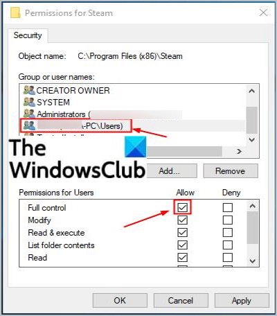

8] Provide full control to the Steam folder security
Try providing full control to the Steam folder security to resolve this error. You can follow the below steps for doing so:
- Firstly, go to the Steam installation directory using method (4).
- Now, right-click on the Steam folder and select Properties.
- Next, in the General tab, uncheck the Read-only (Only applies to files in folder) option.
- After that, move to the Security tab and click the Edit button.
- Then, under the Group or user names, select your user account name.
- Now, check the Allow box for Full Control and press Apply > OK button.
- Finally, relaunch the Steam app with administrator privilege and reattempt the action that was giving you the disk write error. Hopefully, the issue will be fixed now.
