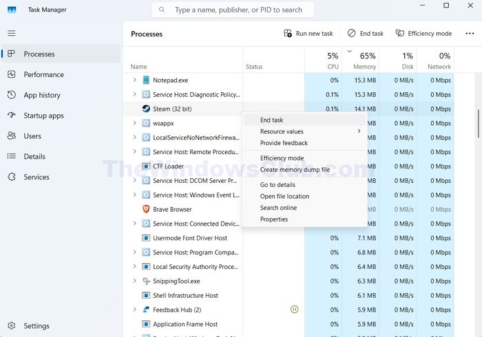

- Press CTRL + ALT + Del to open Task Manager.
- From processes, look for Steam, right-click on it, and select End Task.
- Go to Windows Search, type Steam, right-click on the app and select Run as administrator to run it with full permissions.

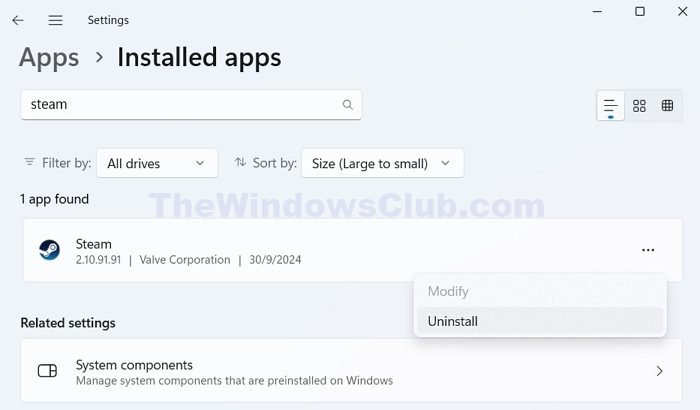

5] Reinstall Steam
In the end, if nothing works out for you, consider reinstalling Steam. This will remove any corrupted or outdated files that might be causing the error.
- First, press Windows Key + I to open Settings.
- Go to Apps > Installed Apps and search for Steam.
- Click on the three dots icon and select Uninstall to remove Steam.
- Once uninstalled, go to the Steam download page, download a new app version, and install it on your PC.
- Finally, check if you are still getting the same Access is denied error in Steam.
