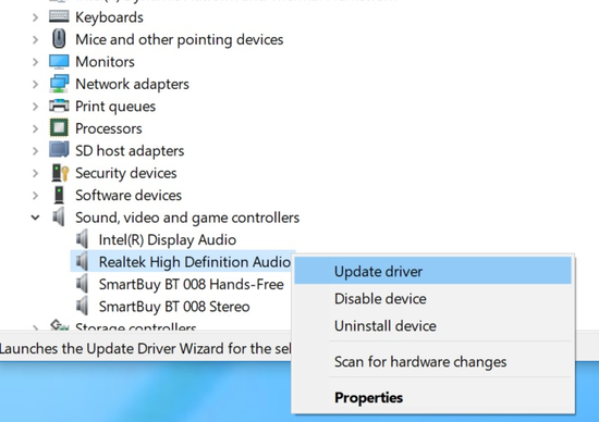

3] Update your audio drivers
Most of the driver issues are resolved by updating the audio drivers. Here is how to do it.
- On your Windows Start menu, press Windows Key + X simultaneously.
- Click Device Manager from the search results.
- Locate and expand Sound, video, and game controllers.
- Select your audio device and right-click on it.
- Click Update Driver from the drop-down menu.
- Click Search automatically for updated software link.
- Follow the instructions on the prompt and wait till the update is complete. Restart your system and check if the problem is reserved.
If the issue persists, continue to the next step.

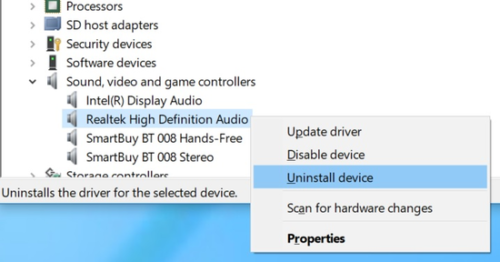

4] Reinstall the Audio Drivers
- On your Windows start menu, press Windows key + X simultaneously.
- Scroll down and expand Sound, video, and game controllers.
- Click Uninstall from the drop-down menu.
- Restart your system. After restart, Windows automatically installs the latest appropriate audio driver.
Now check your device audio and continue to the next step if the issue remains.
