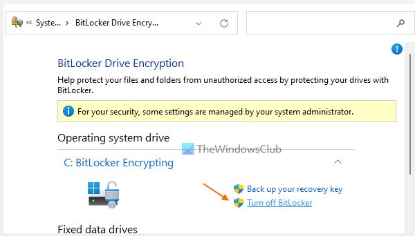

Some users complained about this issue that when they access BitLocker on their Windows 11/10 computer, they see a For your security, some settings are managed by your system administrator message on the top part of the BitLocker Drive Encryption window. This message could appear when you configure and use BitLocker Drive Encryption, encrypt or decrypt a drive, etc. Such a message may also be visible when users open Internet Properties and try to customize the security settings. For both situations, we have added some helpful solutions in this post to fix the issue.

2] Turn off BitLocker for a drive
This is one of the effective solutions to get rid of this problem. For me, this message was gone once I turned off BitLocker protection for my operating system drive. So, turn off BitLocker protection for a drive (fixed data drive, operating system drive, or removable data drive) if you don’t need the encryption anymore or for the time being for that particular drive and see if it helps. To do so:
- Type manage bitlocker in the Search box of Windows 11/10
- Hit the Enter key to open the BitLocker Drive Encryption window
- Expand a drive section
- Use the Turn off BitLocker option for the drive that you want to decrypt or remove the protection.

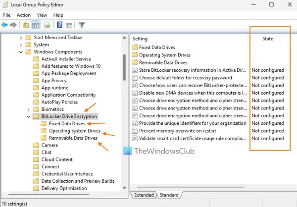

4] Check BitLocker Drive Encryption Group Policy settings
There are certain Group Policy settings for BitLocker available in Windows 11/10 which if configured can put different restrictions on using BitLocker. For example, you can configure a Group Policy setting to enforce drive encryption type to Full encryption or Used Space Only encryption on the operating system drive(s). If any of the available Group Policy settings are configured, then you may see the message that some settings are managed by your system administrator on the BitLocker Drive Encryption window. So, you need to check if some Group Policy settings are configured for BitLocker Drive Encryption. For this:
- Type gpedit.msc in the Search box of Windows 11/10 and press Enter key to open the Group Policy Editor window
- Access the BitLocker Drive Encryption folder in the Group Policy window. For this, use the following path:
Computer Configuration > Administrative Templates > Windows Components > BitLocker Drive Encryption
- On the right-hand section, you will see the main settings for BitLocker Drive Encryption and Fixed Data Drives, Operating System Drives, and Removable Data Drives folders which contain many other settings. Now check if the status of those settings is set to Enabled or Disabled. If yes, double-click on a setting to open it, select the Not Configured option for that setting, and press the OK button.
Repeat these steps for all other settings. Restart your system and then access BitLocker settings. Your problem should be gone now.

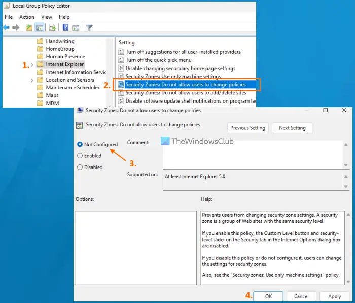

5] Configure Security Zones setting using the Group Policy Editor

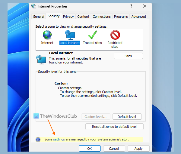

As we mentioned at the start, in another scenario, some users see this Some settings are managed by your system administrator message (as highlighted in the image above) when they try to change Security settings in the Internet Properties window. Because of this, they aren’t able to change the security level on the Internet category, customize the security level or use the Custom level button for the Local intranet, etc.
If you also face this problem and see this message, then it could have happened because a Security Zones setting is enabled in the Group Policy Editor that prevents users from changing the security-level setting and using the custom level button. So, you need to configure that Security Zones setting using the Group Policy Editor.
To do so, use the following steps:
- Open the Group Policy Editor window
- Jump to the Internet Explorer folder. The path is:
Computer Configuration > Administrative Templates > Windows Components > Internet Explorer
- On the right-hand part, double click on the Security Zones: Do not allow users to change policies setting
- If this setting is set to Enabled or Disabled, change it to Not Configured
- Press the OK button
- Close the Group Policy Editor window.

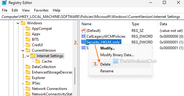

6] Check Internet Settings Registry entry
A correspondence Registry entry for the same Security Zones Group Policy setting (mentioned above) is present in the Registry Editor if it is Enabled. So, you need to find and remove such an entry. For this, you need to check the Internet Settings Registry entry. Here are the steps:
- Type regedit in the Search box and press Enter key
- Access the Internet Settings Registry key under the main root key. Here is the path:
HKEY_LOCAL_MACHINE\SOFTWARE\Policies\Microsoft\Windows\CurrentVersion\Internet Settings
- On the right-hand part, look for
Security_HKLM_onlyDWORD (32-bit) Value - Right-click on that DWORD value and use the Delete option
- In the Confirm Value Delete box, hit the Yes button.
Now check if the error message is gone.
