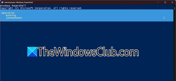

1] Install RSAT BitLocker Recovery Tools via PowerShell
On modern Windows 11/10 and Windows Server, the BitLocker Recovery tab is no longer a default part of ADUC; it is a separate RSAT (Remote Server Administration Tools) component that must be installed. This command adds the necessary module to your system.
Open PowerShell as an administrator and then run the following command.
Add-WindowsCapability -Online -Name Rsat.BitLocker.Recovery.Tools~~~~0.0.1.0
Wait for the installation to complete and then restart your system.
Once done, open ADUC, right-click a computer object, and check for the “BitLocker Recovery” tab.
