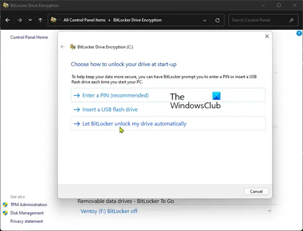

- Next, click Change how drive is unlocked at startup for the OS drive (if you have multiple system drive setup) you want to configure.
- At the next window, click on Enter a PIN (recommended).
- Now, enter a PIN with the specified requirement and Re-enter PIN.
- Click on Set PIN.

- Click Change how drive is unlocked at startup for the OS drive (if you have multiple system drive setup) you want to configure.
- At the next window, click on Let BitLocker automatically unlock my drive.

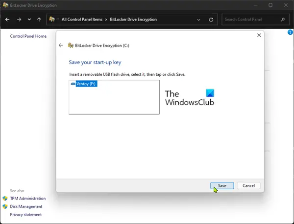

- At the next window, click on Insert a USB flash drive.
- Select the USB flash drive, and click on Save.
The flash drive will not be formatted, so you will not lose anything currently on the USB. The BitLocker startup key for the OS drive will be saved to the USB so it can be used to unlock the OS drive at startup.
