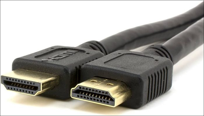

5] Change the HDMI cable
If you have connected an external display to your laptop and its screen flickers when you charge your laptop, the HDMI cable connecting that display to your laptop might be faulty or loosely connected.
If another HDMI cable is available to you, use it. If this fixes the issue, your HDMI cable is faulty.

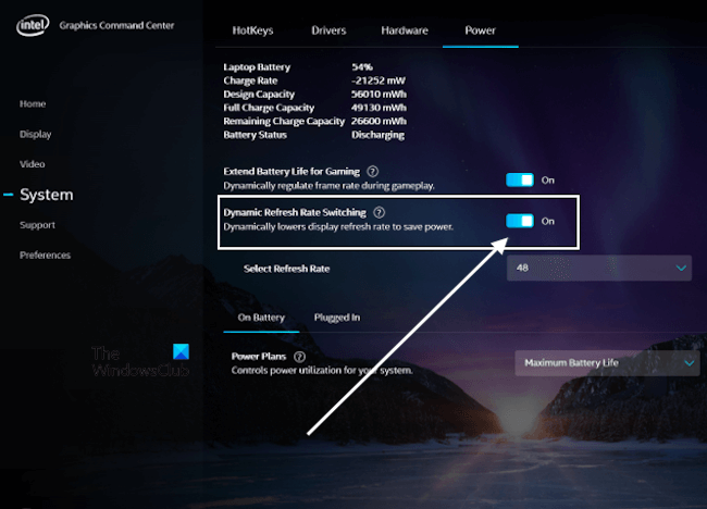

6] Disable the Dynamic Display Rate Switching (if applicable)
This fix is for the users who have Intel Graphics. Some laptops with Intel Graphics have Dynamic Display Rate Switching technology. This technology switches between lower and higher screen refresh rates when the laptop is on battery power and AC power respectively. If you have Intel Graphics, check if this feature is available on your system.
If this feature is available on your laptop, disable it by following the steps provided below:
- Launch the Intel Graphics Command Center through Windows Search.
- Select System from the left side, then select the Power tab on the right side.
- Turn off the Dynamic Refresh Rate Switching option.

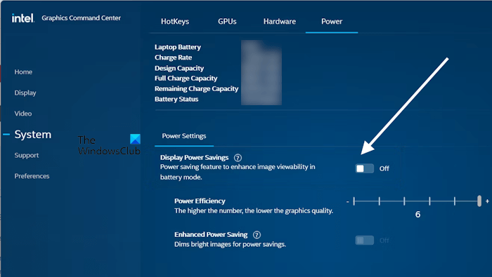

Some laptops with Intel Graphics have the Display Power Savings option. If your laptop has such an option, disable it. This option is also available under the Power tab.

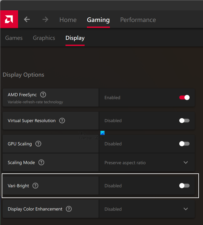

7] Disable Vari-Bright in AMD
If you have AMD Graphics, you can try disabling the Vari-Bright feature in AMD Graphics. Follow the steps provided below:
- Open AMD Software: Adrenalin Edition.
- Select the Gaming tab, then select the Display tab.
- Turn off the Vari-Bright option.

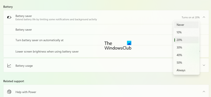

8] Turn off Battery Saver in Settings
If you have turned on the Battery Saver on your system, turn it off and see if it works. The following instructions will help you do that:
- Open Windows 11/10 Settings.
- Go to System > Power & battery.
- Click on the Battery Saver tab to expand it.
- Click on the “Turn battery saver on automatically at” drop-down and select Never.
