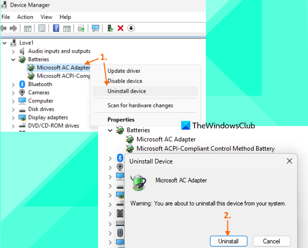

4] Reinstall Battery device drivers
If re-enabling the Battery devices doesn’t solve the issue, reinstalling the battery device drivers should help. For that, use these steps:
- Launch the Device Manager window
- Double-click on the Batteries section to expand it
- Open the right-click menu for a battery device driver (say Microsoft AC Adapter and Microsoft ACPI-Compliant Control Method Battery)
- Click on the Uninstall device option
- In the Uninstall Device box, press the Uninstall button for the confirmation
- Follow the above steps to uninstall the other available battery device drivers
- Restart your laptop.
Now Windows will automatically install the battery drivers after the restart and the wrong battery percentage problem should be fixed.
