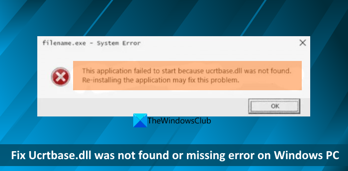

In this post, we will help you fix Ucrtbase.dll was not found or missing error on Windows PC. If this DLL file is removed from your system or gets corrupted, then it may prevent some applications or programs that use this file from running. And when you try to run such a program, you may see the following error:
This application failed to start because ucrtbase.dll was not found. Re-installing the application may fix this problem.

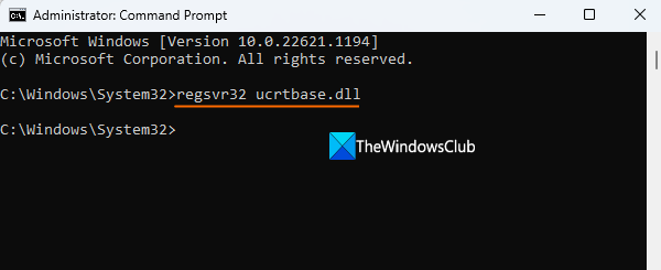

2] Re-register ucrtbase.dll file
If the above solution doesn’t work, then you should re-register the ucrtbase.dll file using the Regsvr32 tool. It is also a built-in command-line tool for Windows 11/10 to unregister, register, or re-register DLL files that you can use if you face some error related to a particular DLL file while opening a program. In this case, to re-register the ucrtbase.dll file, open the Command Prompt window as an administrator, and use the following command:
Regsvr32 ucrtbase.dll
If the command is executed successfully, then restart your Windows 11/10 system, and open the program for which you get the error message. Your problem should be gone now.
If the command doesn’t execute successfully and you receive a DllRegisterServer was not found error, then first adjust permissions for the TypeLib Registry key, temporarily disable your third-party antivirus tool, and then execute the command again.
