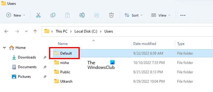

1] Copy the Default user folder from another computer
Computers running on Windows operating system have a Default folder under the Users folder. The Default folder is a template used by Windows to create other user accounts on the same device. You should not delete or modify this folder. When you create a new user account, say The Windows Club, the following things happen:
- A profile folder with the name The Windows Club is created inside the Users folder.
- The contents of the Default folder are copied to The Windows Club folder.
If you delete or modify the Default folder, you may experience issues while signing in to your computer. You will find the Default folder at the following location:
C:\Users

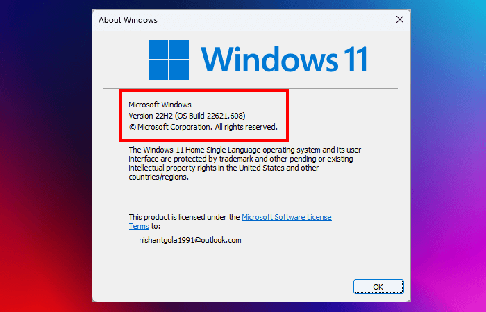

To resolve this problem, copy the Default folder from another computer. Do note that the computer from which you copy the Default folder should have the same Windows version, build number, and language as your computer has. To know the Windows version, follow the steps written below:
- Open the Run command box (Win + R) keys.
- Type winver and click OK.
A new window will open showing you the Windows version and build number (see the above screenshot). On another computer with the same Windows version, build, and language, go to the location where the Default folder is located. If you do not see the Default folder, enable the hidden files and folders in File Explorer. Copy the Default folder in your USB storage device.
Now, turn on your computer. Because you are unable to sign in to Windows because of the corrupted user profile, you have to boot into Safe Mode. After booting into Safe Mode, you can enable the hidden administrator account to make things simpler. Now, go to the location where the Default folder is located. Copy the Default folder to another location on your hard drive for backup. Now, insert the USB storage device and copy the Default folder from the USB storage device to the C drive where the Default folder is located. Replace the Default folder if you get a prompt.

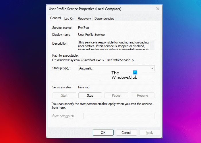

2] Check the status of the User Profile Service
If the User Profile Service is not running, you may experience user profile-related issues on your Windows computer. If you have enabled the hidden administrator account, log in to your system from that account and launch the Services Manager app.
After opening the Services Manager, look for the User Profile Service. Its Status should show Running. If it is stopped, follow the steps written below:
- Right-click on the User Profile Service and select Properties.
- Select the General tab.
- Select Automatic in the Startup type drop-down.
- Click on the Start button.

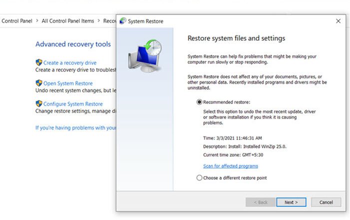

If the issue still persists, modifying or deleting a registry Value will help. This fix has worked for many users. Hence, it should also work for you. Windows Registry is a hierarchical database of system settings and configurations. Modifying Registry Values or keys incorrectly can cause serious errors in your system. Hence, follow the steps provided below carefully. From the safety point of view, create a System Restore Point and back up your Registry before proceeding.
