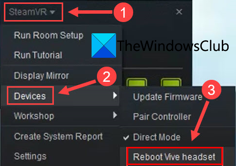

The first thing you should do to fix the issue is to restart your headset and PC. In multiple cases, a simple restart works wonders. So, before trying advanced troubleshooting methods, try restarting SteamVR and see if the issue is fixed. If that doesn’t work, reboot your headset as well as your computer, then check if the problem is fixed. To restart your headset, follow the steps below:
- Firstly, open your SteamVR and press the right-click on the headset icon.
- Now, choose the Devices > Reboot Headset option.
If restarting the devices doesn’t work, try the next potential fix to resolve the problem.

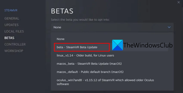

6] Opt into SteamVR Beta
You can consider using the beta version of SteamVR if the issue still persists. SteamVR Beta has many new features and includes bug fixes that might fix the issue at hand. You can try the steps below to opt into SteamVR beta:
- Firstly, start Steam, hover the mouse over LIBRARY, and select the Tools option.
- Now, right-click on SteamVR and then select the Properties option from the right-click context menu.
- After that, go to the BETAS tab.
- Next, press the beta – SteamVR Beta Update option from the drop-down menu present under the BETAS section.
- Finally, exit the Settings window and open SteamVR to see if the issue is now fixed.
In case the problem still persists, we have one more fix for you. So, try the next potential fix to resolve the issue.
