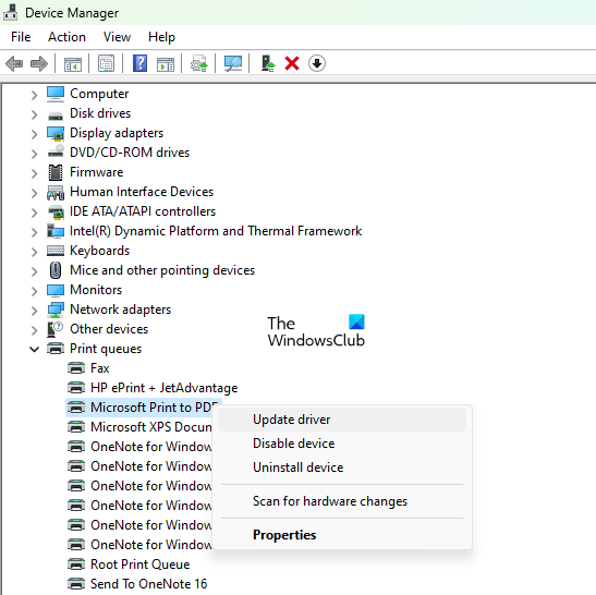

4] Update printer drivers
If the error is triggered due to a faulty or outdated printer driver, updating the driver may resolve the issue. You can go to your printer’s manufacturer’s website and look for the latest available drivers using the serial number of your printer. Then you need to download and install that driver on your Windows PC. Once you’ve updated the printer driver, reboot your system and then try adding the network printer.
