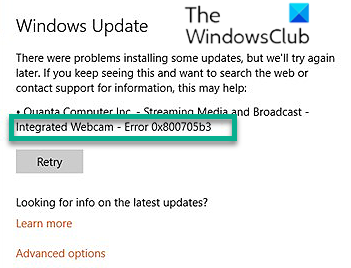

In this article, we will see the possible solutions to fix Windows Update Error 0x800705B3. This type of error generally occurs when a user tries to install some updates on the system. This error is seen after Integrated webcam drivers updates and Bluetooth adapter driver updates. There are many other reasons for this error like corrupted system files, Windows components, etc. If you are getting the same error on your system, this post may help you.

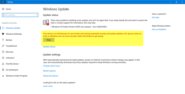

1] Run the Windows Update Troubleshooter
Windows Update Troubleshooter is a powerful tool from Microsoft that can help resolve various Windows update problems. You should run this tool on your computer and see if it helps.
2] Uninstall the Integrated webcam drivers and Bluetooth adapter driver updates
The error is seen after Integrated webcam drivers updates and Bluetooth adapter driver updates. So if you have recently updated these drivers, uninstall or roll them back via the Device Manager and see if that helps.
