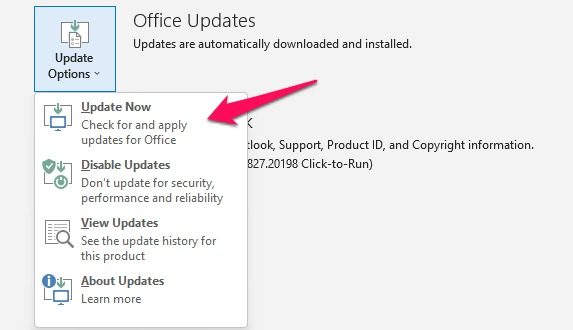

4] Update Outlook
If you are not on the latest version of Outlook, you will most likely have trouble logging in to your account. That is why it is always recommended to keep your up-to-date. To update Outlook, go to File and then go to Account > Update Options > Update Now. It will look for available updates and install them. Once your app is updated, check if the issue is resolved.
