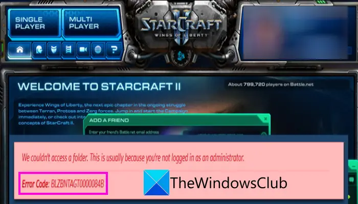

Here is a complete guide to fixing the error code BLZBNTAGT0000084B on Battle.net. Many Battle.net users have reported receiving the error BLZBNTAGT0000084B when playing games on Battle.net. When triggered, you will see the following error message:
We couldn’t access a folder. This is usually because you’re not logged in as an administrator.
Error Code: BLZBNTAGT0000084B
