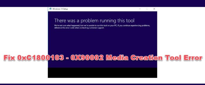

Media Creation Tool is a Microsoft program that is used for the installation of Windows 11/10 into a DVD or USB in order to create a backup and easy access for later reinstallations. People use this Windows backup in case they have an issue with their current Windows and need to reinstall it to fix the issue or just install Windows in other computers. However, like in any program, some Windows users experience the 0xC1800103 – 0x90002 Media Creation Tool Error while using the Media Creation Tool to install Windows 11/10 on a USB or DVD.
There was a problem running this tool, Erroe Code 0xC1800103 – 0x90002
This error suddenly occurs while downloading the ISO for Windows 11/10 or while verifying the installation on a computer and leads to failed installation. Not only does this waste your time as well as data but makes it impossible for you to install Windows through the utility. The error is most times caused due to corrupt files, VPN-related issues, wrong date, and time settings, and many other reasons. Thankfully, there are several ways to fix the issue and we are going to talk about them in this article.
