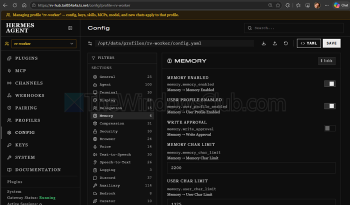

- Declarative memory (MEMORY.md + USER.md): Compact facts that should always be in context, such as the preferred communication style, stable project paths, deployment conventions, and corrections you don’t want repeated.
- Procedural memory (skills): Step-by-step know-how for a specific type of task, such as the commands to run, the pitfalls to avoid, and how to verify success. Skills only load when relevant. Plus, they can be far more detailed than a memory entry without bloating every session.

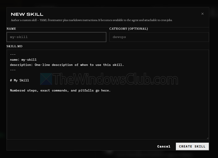

The agent itself writes the skill via a skill_manage tool (create, patch, edit, delete). It triggers automatically when you complete a complex task, hit errors, receive a user correction, etc.
As a user, you don’t need to do any setup. Just use the agent on real multi-step tasks. You can also compile a skill on demand with /learn <description, doc, or codebase> instead of waiting for organic discovery.
