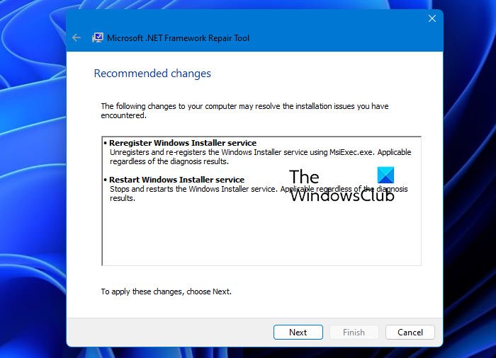

3] Repair .NET Framework
A corrupted .NET framework can also cause the Windows Update error 0x80070306. In such a case, you may receive the following error:
If you receive the above error, you can use Microsoft’s official .NET Framework Repair Tool.

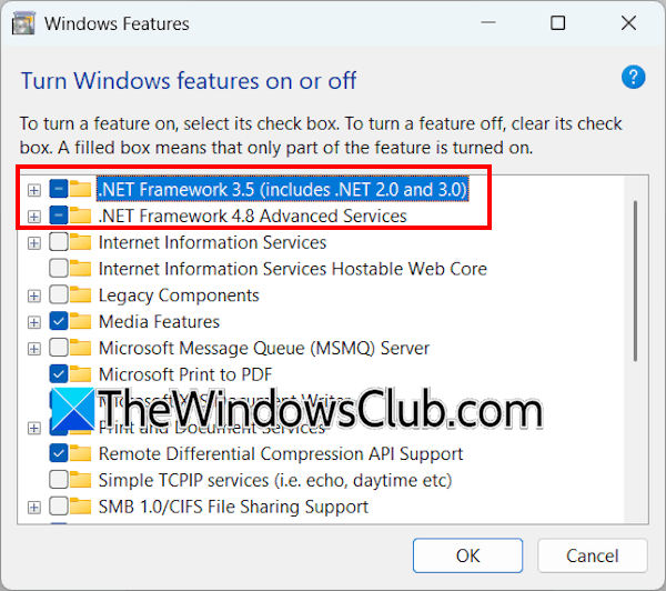

4] Disable and re-enable Microsoft .NET Framework
You can also try disabling and re-enabling the .NET Framework on your system. To do this, follow the steps provided below:
- Click on Windows search and type turn Windows features on and off.
- Click on the best match in the search results.
- Uncheck all .NET Framework versions and click OK.
- Restart your system and open Windows Features again.
- Now, check all the .NET Framework checkboxes and click OK to reinstall them.
- Restart your system.
