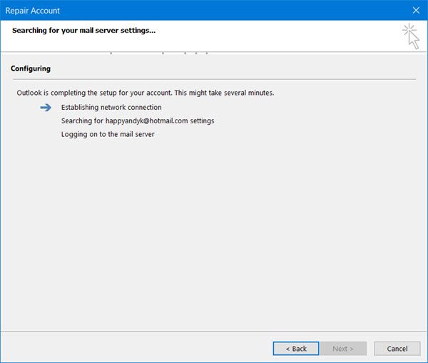

3] Repair or add a new email account
An Outlook email account with corrupted files and settings can be one of the reasons triggering error code 0x8004210B in Outlook. Hence, if the scenario is applicable, you can either repair your email account or remove the current email account and add a new one to check if the error is gone.
To do that, first, open the Control Panel using the Windows Search feature. Now, press the Mail option. If you don’t see the option, type Mail in the search box and click on the Mail (Microsoft Outlook) option.
In the appeared Account Settings dialog window, click on the corrupted account and then press the Repair button. Then, click on the Next button and let it verify and repair your email account. When the process finishes, open Outlook and check if the error is resolved.
If repairing didn’t work, open the Account Settings then press the Remove button.
Once done removing the account, click on the Add button and then enter your email address, name, password, etc., to set up a new email account. When the account is added, select it and click on the Set as Default button.
You can now try sending emails in Outlook using the new account and see if the error code 0x8004210B is fixed.

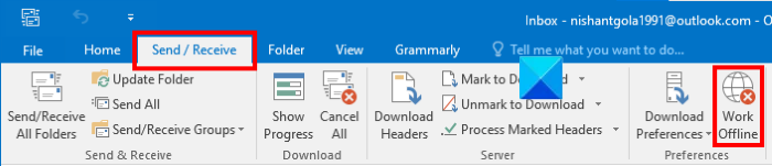

5] Clear the stuck emails
The error might be caused due to stuck emails in your Sent box. Hence, if the scenario applies to you, delete all such stuck emails where you are experiencing error code 0x8004210B and send fresh emails to check if the error is fixed or not. Here are the steps to do that:
First, open the Outlook app and go to the Send / Receive tab.
Now, press the Work Offline to disconnect the app from the internet.
Next, go to your Sent box and select the email message with which you are facing this error. Right-click on the email and choose the Delete option from the context menu to remove it. Similarly, you can delete other such emails.
Now, click on the Work Offline option again from the Send/Receive tab to connect to the internet.
Finally, you can try resending the emails in Outlook and see if the error 0x8004210B is fixed.

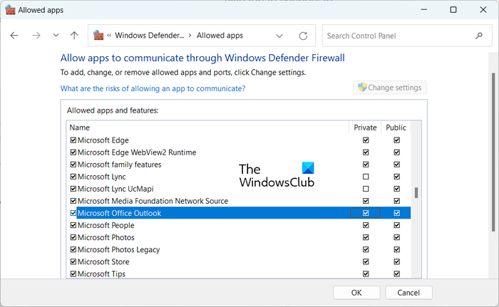

6] Temporarily disable your antivirus/firewall
Sometimes, the error is caused due to interference from your overprotective antivirus or firewall. So, in that case, you can disable your firewall or antivirus for some time and observe whether the error reoccurs. If not, you can be sure it was your security suite causing the error. If this is the scenario, you can add Outlook to the Exception or Exclusion list of your security program.
To allow Outlook through Windows Firewall, use the below steps:
- First, use the Windows key + I hotkey to open the Settings app.
- Now, navigate to the Privacy & security tab and click on the Windows Security > Firewall & network protection option.
- Next, press the Allow an app through firewall option.
- In the appeared window, press the Change settings button and checkmark the Microsoft Office Outlook checkbox.
- Once done, make sure both the Private and Public checkboxes present next to the Outlook app are ticked.
- Finally, click on the OK button to apply new changes and close the window. You can now open Outlook and check if the error code is fixed or not.
