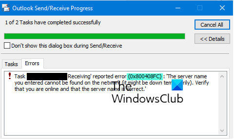

Error messages usually hint you at the root of the problem you’re experiencing. In this case, the Outlook Error 0x800408FC message tells you that two factors cause it – you’re offline, or the server name is wrong. This is similar to the issue of emails stuck in the Outbox.
The server name you entered cannot be found on the network (it might be down temporarily). Please verify that you are online and that the server name is correct.
If you’re online, then you can almost be sure that it’s an issue of an incorrect server name. But this isn’t always the case. After a Windows update, users have received this error, even when their server name is correct.

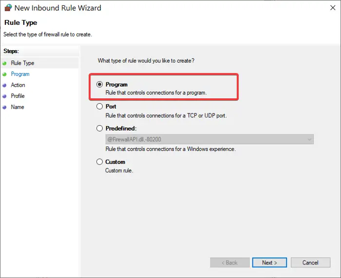

Press the Windows key and search for Firewall. Open Windows Defender Firewall with Advanced Security from the suggestions.
Select Inbound Rules and click on the Action menu.
From the dropdown options, select New Rule.
On the Rule Type window, choose the Program option and hit the Next button.
Select This program path and click on the Browse button. Go to the following path:
C:\Program Files\Microsoft Office\root\Office16
NOTE: The path may be different in your installation and Outlook version, especially the Office16 part. Get your correct directory by right-clicking on the Outlook icon and selecting Open file location.
In this directory, select Outlook.exe and hit Open. Click on the Next button to continue.
Select Allow the connection and hit Next.
Mark the checkboxes beside Domain, Private, and Public. Click Next.
Finally, give the rule a name and optional description. Hit the Finish button to complete the process.

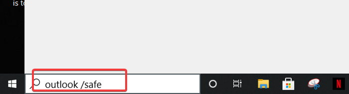

6] Use Outlook in Safe Mode
Now that we’ve troubleshot the connectivity and Outlook account, the next step is to confirm that the Outlook application itself isn’t buggy. For this, you use the Safe Mode.
This method also checks for issues on your profile. Here’s how to do it.
Press the Windows key and click on the search box at the bottom.
Enter the following command and hit ENTER.
outlook.exe /safe
Select a profile next. If there’s a problem, you’ll immediately get a notification that indicates damage in your profile or conflict from add-ins or other software.
