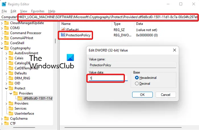

2] Create a new registry key
This problem occurs when you do not have the ProtectionPolicy enabled, so you need to enable it. Before making any changes to the registry data, ensure you have created a backup of the registry settings to restore any lost data.
- Press the Win + R keys together to launch the Run dialog.
- Type regedit in the search bar and hit Enter.
- In the Registry Editor window, navigate to the below path:
HKEY_LOCAL_MACHINE\SOFTWARE\Microsoft\Cryptography\Protect\Providers\df9d8cd0-1501-11d1-8c7a-00c04fc297eb
- Next, right-click on an empty space on the right side, and select New > DWORD (32-bit) Value.
- Rename the new DWORD Value as ProtectionPolicy. Double-click to open the Edit DWORD (32-bit) Value dialog.
- Now, change the Value data field to 1 and press OK. This should fix the Outlook error code 0x8004011c.

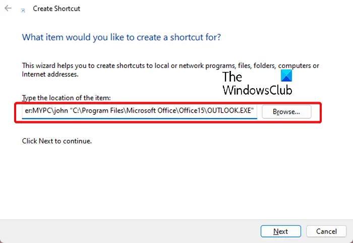

Create a new shortcut
- Right-click on the desktop, select New > Shortcut.
- In the Create Shortcut window, go to Type the location of the item field and type in with john as the local name:
runas /user:ComputerName\Administrator /savecred "C:\Program Files(x86)\Microsoft Office\outlook.exe"
- We must replace “ComputerName” with our device name, for example, DESKTOP-LJ8CVL0. Make sure to verify the correct syntax and path of the Outlook.exe file. Press Next.

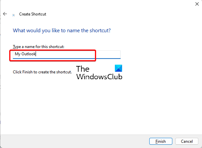

- Next, go to Type a name for this shortcut, and add a name. For example, My Outlook. Click Finish.
