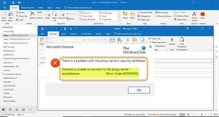

Some Microsoft Outlook users, after upgrading to Windows 11, started reporting that certain versions of Outlook, including Outlook for Microsoft 365 on their systems, that used to connect to the internal Exchange server no longer work, with the error message: “Outlook is unable to connect to the proxy server autodiscover.” This post provides the most applicable solutions to the issue.
When this issue occurs, you’ll receive the following full error message with the error code;
Microsoft Outlook
There is a problem with the proxy server’s security certificate.
Outlook is unable to connect to the proxy server autodiscover. (Error Code 80000000).

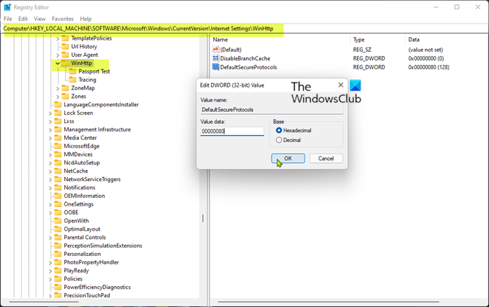

2] Turn on TLS 1.0 on the local Windows 11 machine
This is more of a workaround than a solution. However, this action is not recommended because TLS 1.0 is retired and should be moved away from. Nevertheless, if you need an immediate resolution to the highlighted issue, you can enable TLS 1.0 via the registry on the local Windows 11 machine. Do the following:
Since this is a registry operation, it is recommended that you back up the registry as necessary precautionary measures. Once done, you can proceed as follows:
HKEY_LOCAL_MACHINE\SOFTWARE\Microsoft\Windows\CurrentVersion\Internet Settings\WinHttp
- At the location, on the right pane, double-click the DefaultSecureProtocols entry to edit its properties.
If the key is not present, right-click on the blank space on the right pane and then select New > DWORD (32-bit) Value to create the registry key and then rename the key accordingly and hit Enter.
- Double-click on the new entry to edit its properties.
- Type 00000080 in the Value data field.
- Click OK or hit Enter to save the change.
- Next, jump to the registry path below and repeat the steps as above:
HKEY_LOCAL_MACHINE\SOFTWARE\Wow6432Node\Microsoft\Windows\CurrentVersion\Internet Settings\WinHttp
- Exit Registry Editor when done.
- Restart computer.
