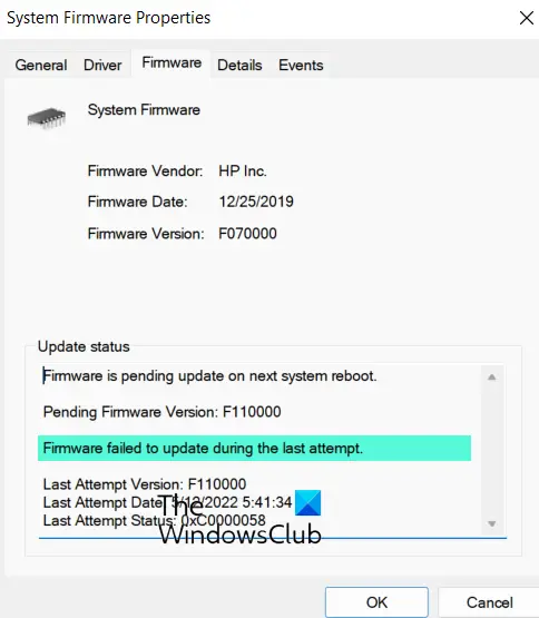

If the firmware update failed or was not installed correctly, you will see a yellow-colored exclamation mark on your firmware. Now, right-click on the firmware and select Properties to view the error codes for firmware update failure.

The error codes available after a firmware update failure are called Return codes. These return codes let Windows OS know about the success and failure of the firmware update installation. Users can view these error codes in Windows 11/10 Settings and the Device Manager. The UEFI firmware update failure is categorized into two types:
- Transient failures
- Non-transient failures
Firmware failed to update during the last attempt
1] Transient firmware update failures
The transient firmware update failures occur due to temporary conditions such as power outages or low battery levels. If the firmware update fails due to low battery power, Windows always tries to install it after the next restart. If the update fails for any reason other than a power outage or battery issue, Windows makes only three reinstallation attempts. After that, it displays the “Update failed” error message in Device Manager or the Windows Update history. In this case, the firmware will not be updated until the manufacturer releases a new update.
2] Non-transient firmware update failures
The non-transient firmware update failures occur due to conditions that cannot be repaired. In such a case, Windows does not retry the firmware update until a new update is released from the manufacturer.
Let’s see some common firmware update error codes users may see in Windows Update or Device Manager. Each of these error codes has an NTSTATUS value. The NTSTATUS values are used to communicate with the system information. Most of these values have a default message that is displayed in the human-readable text message along with the error code. Users can use these error codes and descriptions to resolve the problem.

When the UEFI firmware reports the STATUS_UNSUCCESSFUL value to the Windows OS, Windows attempts reinstallation three times. During the three reinstallation attempts, the user will see a Pending restart message in the Windows Update. If all three attempts fail, Windows displays a message {Operation Failed} The requested operation was unsuccessful along with the error code 0xC0000001.
Windows makes three reinstallation attempts when the UEFI firmware reports the STATUS_INSUFFICIENT_RESOURCES value. During these three reinstallation attempts, the “Pending restart” message appears in Windows Update. If despite making the three attempts, the firmware update fails, Windows displays the Insufficient system resources exist to complete the API error message with the code 0xC000009A.
Windows does not attempt to reinstall firmware upon receiving any of the following NTSTATUS values. Instead, it displays the respective error code and the error message.
- STATUS_REVISION_MISMATCH
- STATUS_INVALID_IMAGE_FORMAT
- STATUS_UNKNOWN_REVISION
- STATUS_NO_SUCH_FILE
On receiving the STATUS_ACCESS_DENIED value by the UEFI firmware, Windows makes three reinstallation attempts. If after these three attempts, the firmware update fails, Windows displays the error code 0xC0000022 with an error message.
The UEFI firmware reports the following two NTSTATUS values to Windows OS if the firmware update fails due to the power or battery outage issue. In this case, there is no limit to firmware update reinstallation attempts.
- STATUS_POWER_STATE_INVALID
- STATUS_INSUFFICIENT_POWER
