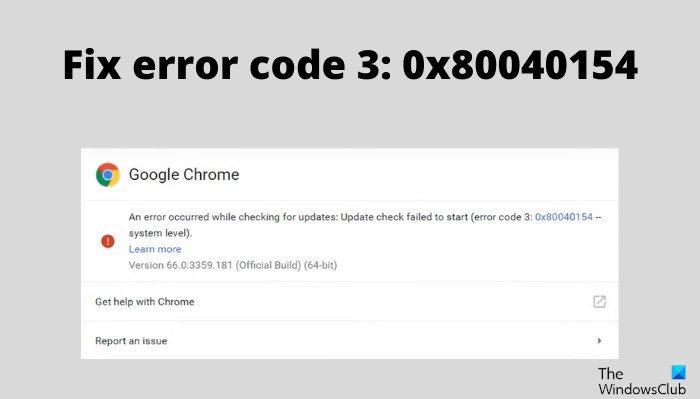

This post features solutions to try if you face Error Code 3 0x80040154 in Google Chrome or Microsoft Edge. Edge and Chrome are among the best browsers available for Windows. Like any other application, they receive constant updates featuring performance upgrades and bug fixes. But while downloading the update, some users have reported facing this error:
An error occurred while checking for updates. Update check failed to start (error code 3: 0x80040154 – system level).
