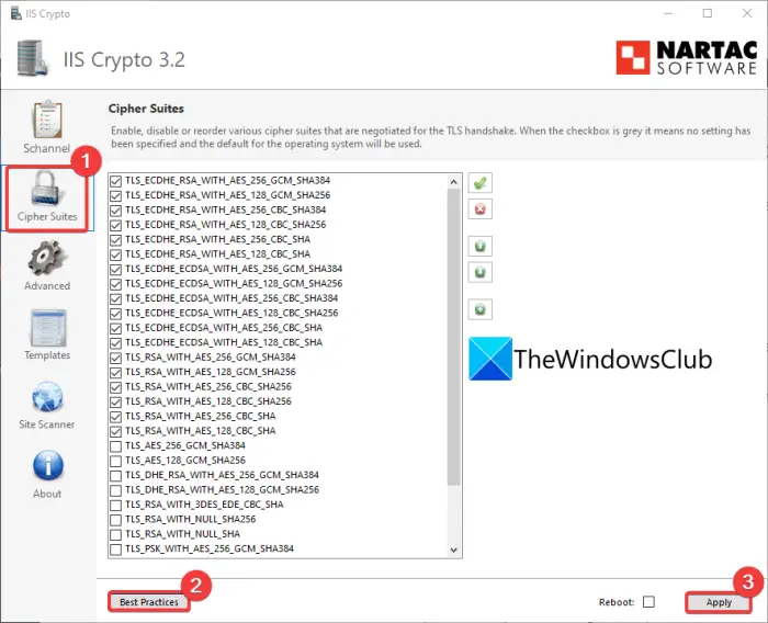

4] Disable Weak Cipher suite using IIS Crypto
You can also try disabling weaker cipher suites in order to fix this error in Chrome. To do that without any hassle or noise, you can use this free tool called IIS Crypto. It is free software that lets you enable or disable ciphers, protocols, hashes, and key exchange algorithms on Windows Server 2008, 2012, 2016, and 2019 with a single click.
You can download this software on your PC and then launch this application. It is portable, so requires no installation. After starting this software, click on the Cipher Suites menu present on the left panel and then press on the Best Practices button. Doing this will disable weaker cipher suites and protocols and make your server use the best practices for TLS. The advanced users can manually select/ deselect weaker cipher suites accordingly. To save changes, click on the Apply button and reboot your PC. This will disable all the weaker ciphers and make sure you are using secure protocols on your Windows Server.
See if this method works for you and resolves the error in Chrome.
