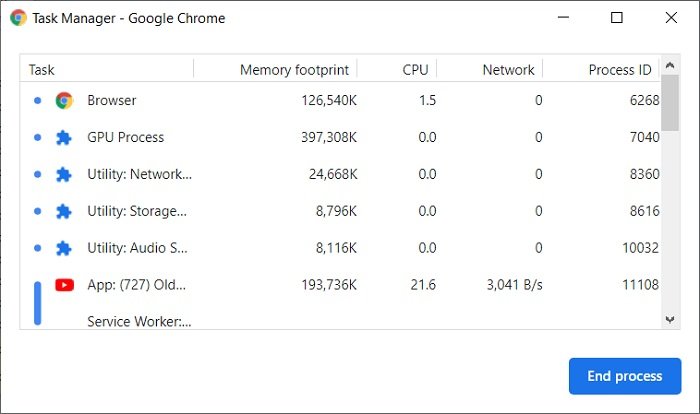

Before we proceed with the fix, we first need to learn why Google runs multiple processes even for a single window open. This is essentially a default setting in Chrome that runs multiple processes for each tab, utility, and extension. Chrome does this to avoid any data loss if any of your tabs crash. While Windows Task Manager will only show chrome.exe running, you can check the details in Chrome Task Manager. Check the screenshot below, and it shows that Google Chrome runs a separate process for each of its utility and extensions too.

2] End tasks manually via Chrome Task Manager
You can end the tasks manually. Remember to do this via Chrome Task Manager, wherein you can see which processes are running and which of those you want to end.
To launch Chrome Task Manager, press Shift+Esc keys on your keyboard or you can go via Settings > More tools > Task Manager.
Select the task you want to terminate and click on End process.

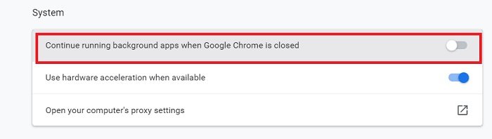

5] End apps running in the background
Google Chrome runs the web apps and installed extensions in the background even when it is closed and they run unless you end them manually.
- To end the apps running in the background, go to Settings.
- Click on ‘Advanced’ from the left panel
- Under the ‘System’ tab, you will see a box saying: Continue running background apps when Google Chrome is closed
- Uncheck this box.
