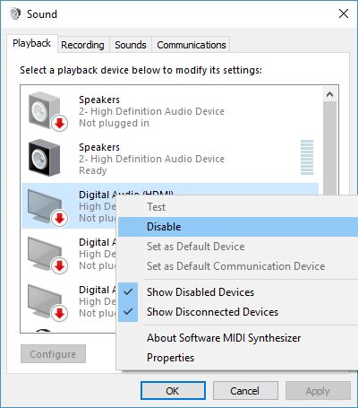

3] Disable Digital Audio
If you have two playback devices enabled on your personal computer, then there’s a chance Cortana might conflict with one of them, and that will likely cause the Microsoft voice assistant to lose its voice.
What you’ll need to do, then, is right-click on the Sound icon, then select Playback devices from the menu. Locate the Digital Audio output you’re not using and Disable it, and from there, restart the computer and check if Cortana is back to her talkative self.
For the situation this doesn’t work, then it’s time to take drastic measures to fix the problem once and for all.
