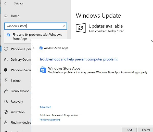

1] Run Windows Store Apps Troubleshooter
It is possible that this error can be subsided by running a troubleshooter for the Windows Store Apps. In order to run this troubleshooter, you have to follow the steps below:
- Open up your Windows Settings by pressing the Windows and ‘I’ key together.
- Here, select Update & Security and further click on Troubleshoot.
- Navigate through the white panel on the right and search for Windows Store Apps.
- Select that option and click on ‘Run the Troubleshooter’. The process generally takes a few minutes to complete.
After the troubleshooter ends, it will either show to you the issues running on your computer and their subsequent fixes, or it will present the report of a clean slate, in which case you will have to resort to the alternatives we have mentioned below.

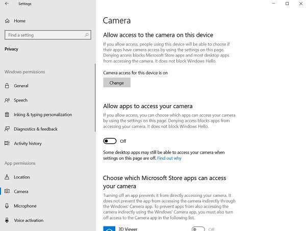

2] Check Camera settings for app permissions
This error may also be a consequence of your camera’s misadjusted privacy settings. It is possible that Windows has restricted the use of the webcam on various apps. In a scenario where users try to open apps where permission to use the built-in webcam isn’t granted, they may be presented with the Error 0xa00f4246.
To ensure that camera access settings aren’t causing (and to rectify if they are), follow the steps below:
- On the Taskbar Search Pane type the word ‘Privacy’ and click on the subsequent settings page that shows up.
- Select Camera.
- Turn on the setting that says ‘Allow Apps to access your camera.’
- Reboot your device and check if the error has been fixed.

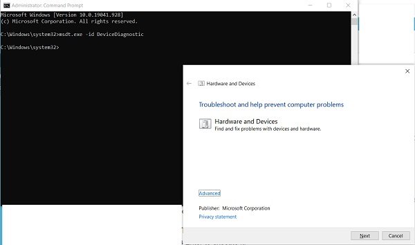

4] Run Hardware and Devices Troubleshooter
If your computer is running on any kind of damaged hardware, it exposes the system to all kinds of errors, the error in question being one of them. In order to ensure that your Hard Disk Drive (HDD) is safe, you have to run Hardware and Devices Troubleshooter. Follow the steps below to do so:
- Type Command Prompt in the Taskbar Search Pane and further select it to Run as Administrator.
- Type the code below and press Enter to execute it.
msdt.exe -id DeviceDiagnostic
- This will further launch a separate window asking you to proceed with the troubleshooter. Select ‘next’ and wait for the scan to complete.
After the scan is complete, you’ll be shown a report of your Hard Drive’s current state and if it reports any bugs, then you are advised to get it replaced.
