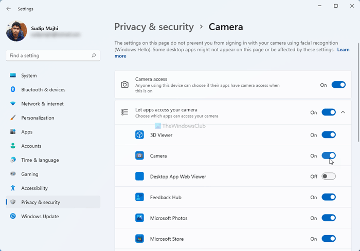

2] Turn on camera access for affected apps
This solution is helpful if the webcam is working on a few apps but not on the Camera app and other apps. This can happen if the camera or webcam access is turned off or disabled for such apps. Navigate to Settings app > Privacy & security > Camera. Turn on the camera access for the apps (desktop applications and Microsoft Store apps) in the list under the Let apps access your camera section.

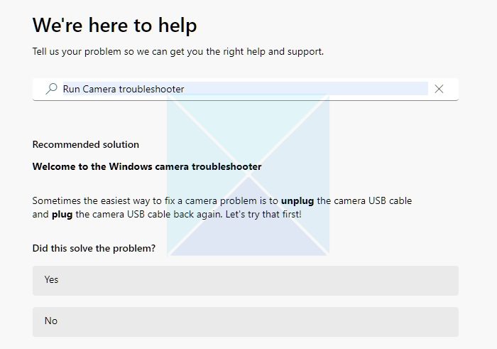

3] Use Camera Troubleshooter in the Get Help app
The native Camera troubleshooter in the Get Help app of Windows PC can also be helpful in resolving this problem. It runs automatic diagnostics to help fix the camera problems.
Open the Settings app and navigate to Bluetooth & devices > Cameras. In the Connected cameras section, select a camera for which you get this error, and press the Troubleshoot button. The Get Help app will open. Click on the Troubleshoot Camera in Windows 11 option and follow the next steps to fix the issue.

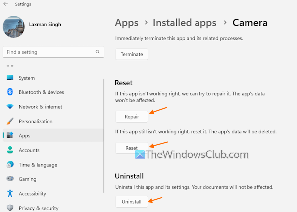

5] Repair or reset the Camera app
If the problem is with the Camera app itself, resetting or repairing the app can help solve this problem. While the repair option doesn’t affect app data, the reset option deletes all the data.
To reset or repair the Camera app, open the Settings app. Navigate to Apps > Installed apps > Camera > Advanced options. Now you can use the Repair button or Reset button. If this doesn’t work, uninstall the app and reinstall it.
