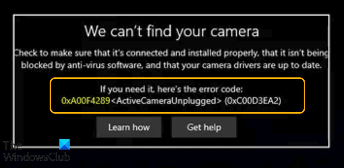

If when you try to access your laptop’s webcam through the built-in Camera app on your Windows 11 or Windows 10 PC, but you receive the error code 0xA00F4289 (0xC00D3EA2), then this post is intended to help you with the most suitable solutions to resolve the issue.
When you encounter this issue, you’ll receive the following full error message;
We can’t find your camera
Check to make sure that it’s connected and installed properly, that it isn’t being blocked by anti-virus software, and that your camera drivers are up to date.
If you need it here’s the error code:
0xA00F4289 < ActiveCameraUnplugged > (0xC00D3EA2)
