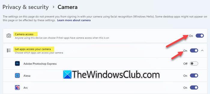

4] Check your Privacy settings
The next step is to check your privacy settings. Your webcam might be blocked. Follow the instructions provided below:
- Open Windows 11 Settings.
- Go to Privacy & Security > Camera.
- The Camera access button should be turned on. If it is off, turn it on.
- Also, expand the Let apps access your camera tab and turn on the camera access for the desired apps.

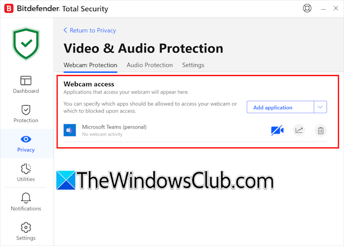

5] Temporarily disable your antivirus
Your antivirus might be blocking your webcam. To check this, disable your antivirus and check if the issue persists. If this helps, manage webcam protection in your antivirus settings. If you do not know how to do this, refer to the support page of your antivirus.
