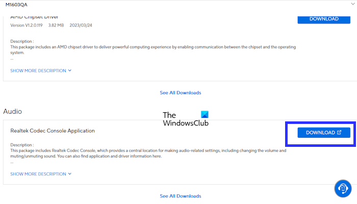

2] Download the driver from the official website
You can also try installing the device driver without uninstalling the previously installed driver. Download the latest driver version from your computer manufacturer’s official website and run the installer file to install the driver.
If this fixes the issue and your device starts working again, you do not need to uninstall the driver.

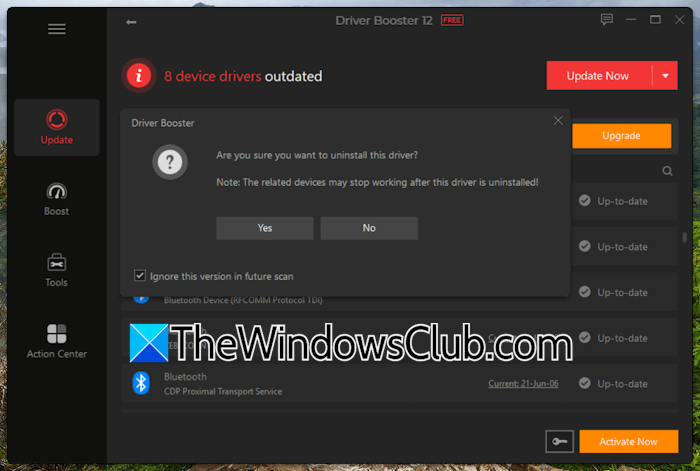

4] Use a third-party tool to uninstall the driver
Third-party driver updater software helps you update your device drivers to the latest version. You can also use driver updater software, such as IObit Driver Booster to uninstall your device drivers.
