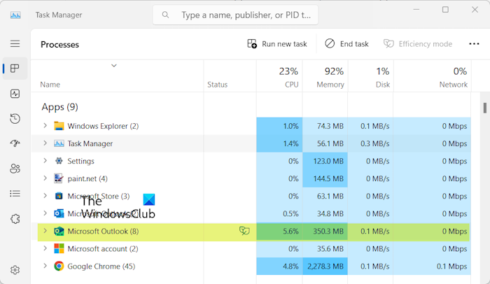

1] Close Outlook completely and restart it
The first thing to do to fix the issue is to restart the Outlook app. It could be a temporary issue causing the problem. So, close the Outlook app completely and then reopen it to check if appointments and events are showing in the calendar.
To close Outlook, open Task Manager using Ctrl+Shift+Esc and go to the Processes tab. Now, select the Outlook process and press the End task button. Similarly, close all related processes. Finally, reopen the app and check if the issue is fixed.

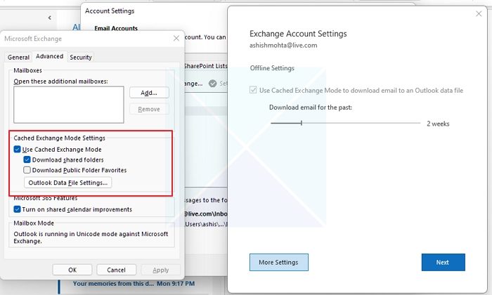

3] Turn off Caching In Outlook
The next thing you can do to fix this issue is to disable the caching of shared folders on Outlook. This fix has been proven to be effective for some affected users, so you can try the same and see if it helps. Here’s how:
- First, open Outlook and go to the File menu.
- Now, go to the Account Settings drop-down option and click on the Account Settings option.
- Next, select your active account and press the Change button.
- After that, click on the More Settings option.
- Now, move to the Advanced tab and uncheck the Download shared folders checkbox.
- Finally, press the OK button to save changes and see if the problem is fixed.
