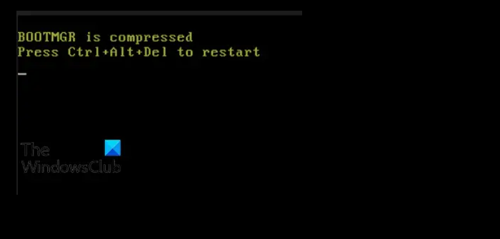

If when you boot your Windows 11/10 device, but your computer fails to boot and you only see a black screen with the message BOOTMGR is compressed, Press Ctrl+Alt+Del to restart, then this post is likely to help you.
File compression is a feature that allows PC users to decrease the size of files, folders, and programs, and reduce disk space usage. However, since the system boot sector code lacks the ability to decompress files by itself, the BOOTMGR file, which is a key part of the booting process, should not be compressed, otherwise, you’ll encounter this error on Windows 10 startup.
BOOTMGR is compressed error in Windows 11/10
