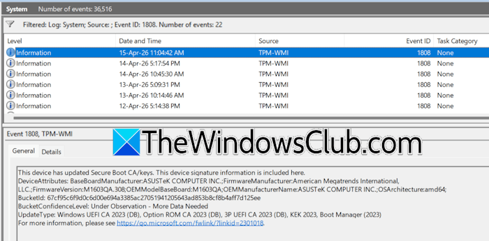

1] Checking the Event Logs
Windows 11 records different events, including errors, warnings, and updates, as logs. You can view all these logs in the built-in tool, Event Viewer. Event ID 1808 is recorded for the updated Secure Boot Certificates. This Event ID states that the device has the latest Secure Boot Certificates. Follow the steps provided below:
- Launch Event Viewer.
- Expand Windows Logs and select System.
- Click Filter Current Log on the right side.
- A new pop-up window will appear on your screen. Enter 1808 in the field that says <All Event IDs>.
- Click OK.
If the Event Viewer shows results for Event ID 1808, it means Windows has downloaded the latest Secure Boot Certificates on your system. However, the certificates have not yet been applied or installed.

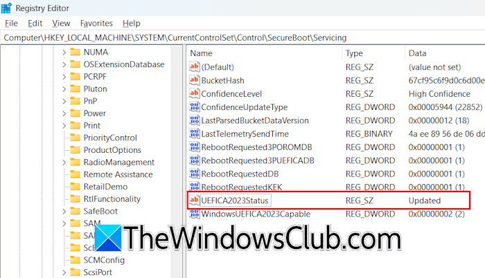

2] Understanding the Registry value UEFICA2023Status
Now, let’s understand the Registry value UEFICA2023Status. Copy the following path, open the Registry Editor, and paste it into the address bar of the Registry Editor. After that, press Enter.
Computer\HKEY_LOCAL_MACHINE\SYSTEM\CurrentControlSet\Control\SecureBoot\Servicing
Make sure that the Servicing key is selected on the left side. Now, look for the value UEFICA2023Status on the right side. Its data should show Updated. If so, you do not need to worry anymore. However, if its Data shows any of the following messages, you need to troubleshoot further to know the underlying cause stopping Windows from installing the new Secure Boot Certificates.
- NotStarted
- InProgress
The NotStarted Data indicates that the update has not yet run, whereas the Data InProgress means that the update is actively in progress. If the UEFICA2023Status value shows InProgress, you do not need to take any action, as the update process is ongoing and its status will soon change to Updated. However, if you see NotStarted, initially, wait for a few days and see if it changes to Updated. If not, step into further troubleshooting.

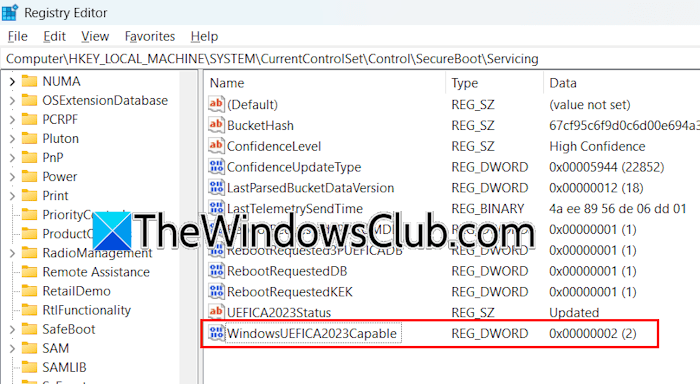

Look for another value in the same Servicing key in the Registry Editor, WindowsUEFICA2023Capable. The Data of this value will show you the exact picture. The Registry Value WindowsUEFICA2023Capable shows any of the following three results:
- 0 or missing: Windows UEFI CA 2023 certificate is not in the DB (data base).
- 1: Windows UEFI CA 2023 certificate is in the DB (data base).
- 2: Windows UEFI CA 2023 certificate is in the DB (data base), and the system is starting from the 2023 signed boot manager.
The value 2 means that the system is using the new Secure Boot Certificates. Therefore, no action is required by the user. If the value is 1, the latest certificates are available in the database but have not yet been installed by Windows. Something might be preventing Windows from installing the new certificates. In this case, you can wait for a few days and see if the value changes from 1 to 2. If not, then further troubleshooting is required.
If the WindowsUEFICA2023Capable value shows 0 or is missing, it means the latest Secure Boot Certificates are not available in your system’s database. Now, one thing has been confirmed: Windows has not downloaded the new certificates yet. Further troubleshooting is required.
Now, check the Registry Value UEFICA2023Error. If everything is fine on your system, it should not exist or show 0 (if it exists). If the UEFICA2023Error value exists and shows a value other than 0, this means that your system has an underlying issue preventing Windows from downloading or installing the new Secure Boot Certificates.

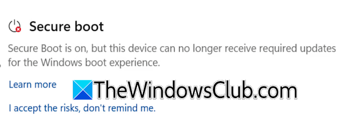

D] This device can no longer receive required updates
The complete message is:
Secure Boot is on, but this device can no longer receive required updates for the Windows boot experience.
This message indicates that your device is using older certificates, and the new ones cannot be installed. This usually happens when your device’s firmware does not support new certificates. In this case, contact your device’s manufacturer to get BIOS updates. If your device manufacturer does not release a BIOS update, your device will unfortunately not receive the new certificates.
