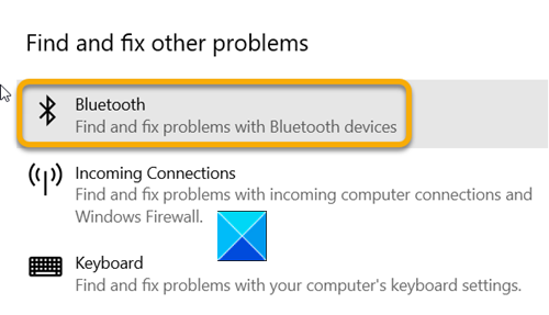

1] Run the Bluetooth Troubleshooter
Because the problem is occurring on the Bluetooth mouse, running the Bluetooth Troubleshooter may fix it. Troubleshooters are automated tools developed by Microsoft that help users fix common issues on their systems.
Windows 11 and Windows 10 have different user interfaces. Therefore, the steps to run the Bluetooth Troubleshooter differ for Windows 11 and Windows 10 users.
Windows 11
You can run Bluetooth Troubleshooter on your Windows 11 computer by following the below instructions:
- Right-click on Start and select Settings.
- Go to “System > Troubleshoot > Other Troubleshooters.”
- No, click on the Run button next to the Bluetooth.
Windows 10
Windows 10 users have to go through the following steps:
- Go to “Update & Security > Troubleshoot > Additional Troubleshooters.”
- Scroll down and select Bluetooth.
- Now, click Run the Troubleshooter.
Let the troubleshooter finish its work. You can also try running the Hardware and Devices Troubleshooter.
Now, check whether the scroll button is working or not.
