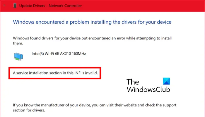

If you see A service installation section in this INF is invalid error while installing or updating a device driver on Windows 11/10, then this post is sure to help you.
What causes A service installation section in this INF is invalid error?
This error occurs if you try to manually install a Driver using a .INF File in Windows using the “Install” option in right-click context menu. This error might be caused due toa corrupted .inf driver file or a mismatch between the device and the driver. This error is reported to occur with MTP device driver, Wi-Fi driver, or any other driver for that matter.
Fix A service installation section in this INF is invalid error
To fix this error, re-download the .inf driver file to a different location and try installing it to see if it works. Here are some suggestions to help you resolve this error.

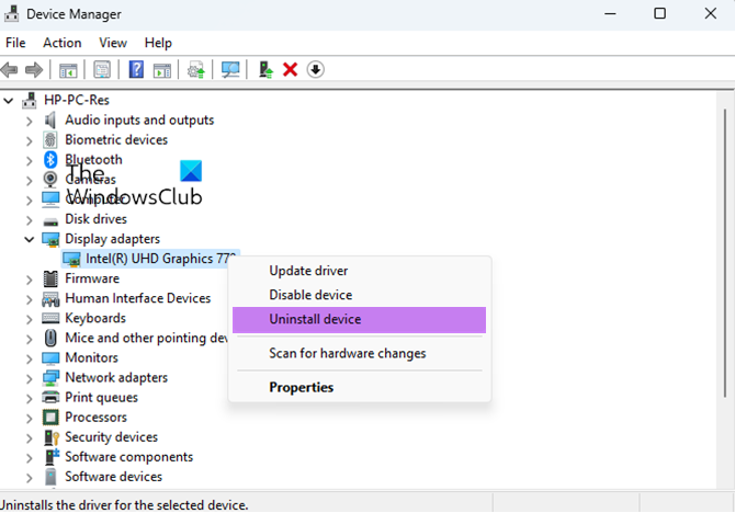

First, open the Device Manager app from the Win+X menu. After that, locate the problematic driver and right-click on it. From the context menu, select the Uninstall device option and then follow the prompted instructions to complete the process.
When the above command is finished, you can restart your computer.

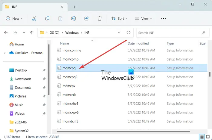

C:\Windows\INF
Now, locate the mdmcpq.inf file and copy and paste it to an external drive. After that, move to the below location:

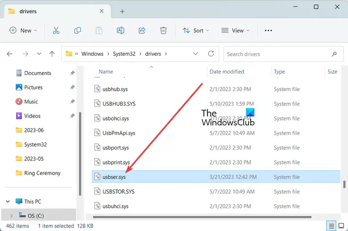

C:\Windows\System32\drivers
From the above location, copy the usbser.sys file to the same external drive that you used previously.
Next, connect the external drive to the problematic computer and copy both files to their respective locations. Copy and paste the mdmcpq.inf to C:\Windows\INF and the usbser.sys file to C:\Windows\System32\drivers.

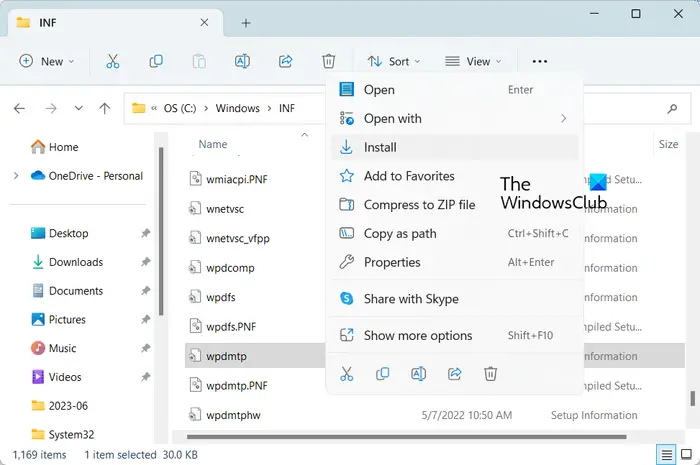

Another way to install a missing driver file to fix this error is as follows:
First, disconnect your USB device and move to the C:\Windows\INF location in your File Explorer. Now, right-click on the wpdmtp.inf file and choose the Install option from the appeared context menu. Next, wait for the process to finish. Once done, reconnect your device and check if the A service installation section in this INF is invalid error is fixed or not.
