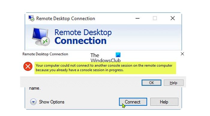

If remote desktop can’t connect to the remote computer and fails with the error message Your computer could not connect to another console session on your Windows 11 or Windows 10 computer, then this post is intended to help you with the most applicable solutions to resolve the issue.
When this issue occurs on your Windows 11/10 PC, you will receive an error prompt displaying the following full error message;
Remote Desktop Connection
Your computer could not connect to console session on the remote computer because you already have a console session in progress.
Typically, you are most likely to encounter this error because one of the network adapters on the computer (source) you’re trying to remote connect from has the same IP address with the computer (destination) that you are trying to connect to via the remote desktop protocol.
If you’re getting the error message Your computer could not connect to another console session on your Windows 11/10 computer, consequently preventing you from establishing a remote connection, you can try our suggestions below to have the issue resolved in no time!
