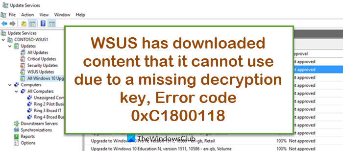

If you have encountered the Windows Upgrade error 0xC1800118 when WSUS (Windows Server Update Services) attempts to sync upgrades classification on Windows Server machines, then this post is intended to help you with the most suitable solutions to fix the issue.
The error description reads as follows;
WSUS has downloaded content that it cannot use due to a missing decryption key.

As indicated in the error description, the Windows Upgrade error code 0xC1800118 on WSUS occurs because WSUS has downloaded content that it cannot use. The error is due to parsing only happens once, and WSUS does not know what “Upgrades”. One of the updates you need to ensure is installed is KB3159706. Consequently, WSUS incorrectly identifies the Feature Upgrade as a Quality Update and saves it to the SUSDB as well as to all managed Windows 11/10 clients. In this case, until the patch is applied, unusable content is purged, and WSUS properly syncs the information; any subsequent upgrade will fail.
Such essential updates have been released through WSUS, allowing you to sync or import them and then deploy them from your WSUS. In the event you are currently unable to deploy the update using WSUS, you can check for updates via Windows Update on the WSUS server, or you can manually download the update from Microsoft Update Catalog, then run the standalone installer to install the package on the WSUS server.
2] Run WSUS Server Cleanup Wizard
According to Microsoft documentation, this situation is recoverable but the process is nontrivial and can be avoided altogether if you make sure to install the KB3159706 update before enabling sync of upgrades to the Windows clients. However, if you have encountered this issue, and after installing the required update on the WSUS, but the error persists, you can run the WSUS Server Cleanup Wizard to fully clean your WSUS server and the affected Windows 11/10 clients. Afterwards, you can try installing the KB3159706 update again.
To troubleshoot WSUS to fix the issue, you can run the WSUS Server Cleanup Wizard to clean your environment after downloading unsupported encrypted Upgrades to WSUS.
Do the following:
- In the WSUS administration console, select Options.
- Next, select Server Cleanup Wizard.
Note: By default this wizard will remove unneeded content and computers that have not contacted the server for 30 days or more.
- Next, select all possible options.
- When done click Next. The wizard will begin the cleanup process, and will present a summary of the procedure when it completes.
- Click Finish to complete the process.
