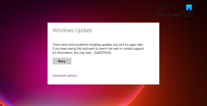

Sometimes you may find that your Windows 11/10 is stuck with Windows Update status being displayed as Pending install, Pending download, Initializing, Downloading, Installing or Awaiting install. This post explains what these terms mean. If you face this issue, here’s what you can do to resolve the issue.
All Windows Update stages have a status. While they may get displayed under normal circumstances, they do get displayed when the update process is stuck. It can be because of the settings on the computer, or it could be because of the users choice. These are the types of Windows Update status you may see:
