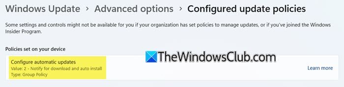

Double-click on Configure Automatic Updates to open its configuration box. Select Enabled, and then from the available Options, from the drop-down menu, select Notify for download and notify for install. Click on Apply and Exit. Restart your computer.
windows 10 gp 2
This policy specifies whether this computer will receive security updates and other important downloads through the Windows automatic updating service.
This setting lets you specify whether automatic updates are enabled on this computer. If the service is enabled, you must select one of the four options in the Group Policy Setting:
  • 2 – Notify before downloading and installing any updates. When Windows finds updates that apply to this computer, users will be notified that updates are ready to be downloaded. After going to Windows Update, users can download and install any available updates.
  • 3 – (Default setting) Download the updates automatically and notify when they are ready to be installed. Windows finds updates that apply to the computer and downloads them in the background (the user is not notified or interrupted during this process). When the downloads are complete, users will be notified that they are ready to install. After going to Windows Update, users can install them.
  • 4 – Automatically download updates and install them on the schedule specified below. Specify the schedule using the options in the Group Policy Setting. If no schedule is specified, the default schedule for all installations will be every day at 3:00 AM. If any updates require a restart to complete the installation, Windows will restart the computer automatically. (If a user is signed in to the computer when Windows is ready to restart, the user will be notified and given the option to delay the restart.) On Windows 8 and later, you can set updates to install during automatic maintenance instead of a specific schedule.
  • 5 – Allow local administrators to select the configuration mode that Automatic Updates should notify and install updates. With this option, local administrators will be allowed to use the Windows Update control panel to select a configuration option of their choice. Local administrators will not be allowed to disable the configuration for Automatic Updates.
If the status for this policy is set to Disabled, any updates that are available on Windows Update must be downloaded and installed manually. To do this, search for Windows Update using Start. If the status is set to Not Configured, use of Automatic Updates is not specified at the Group Policy level. However, an administrator can still configure Automatic Updates through Control Panel.
Now if you open Settings Update & Security > Windows Update > Advanced Options, you will a grayed out Notify to download button and a notification saying Some settings are managed by your organization.

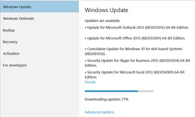

Clicking on the notification, will open the Update Settings. I could see that some updates were available and ready to download.
cumulation updates windows 10
Clicking on Download, started the download process.
downloading updates10
