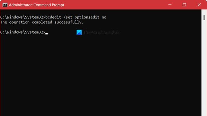

3] Disable the Edit Boot Options screen
To disable the Edit Boot Options screen, we need you to enter your operating system. Once done, open Command Prompt as an administrator. You can do this by searching the CMD from the Start Menu, right-clicking on the icon once it appears, and then selecting Run as administrator. Click Yes when the UAC prompt appears. Finally, run the following command.
bcdedit /set optionsedit no
It should say – The operation completed successfully.
You will not get the glitching boot screen every time you start your computer.
