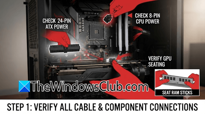

1] Check all connections properly
This is the first step. Check all cable connections properly. Make sure the cable connecting your second SSD is not loose. If another cable is available, change it. Additionally, verify that your GPU is properly plugged in and your RAM sticks are firmly seated. Sometimes, while installing a hardware component, we mistakenly loosen or disconnect other hardware components, such as RAM or GPU. This might have happened to you. Check and fix this.

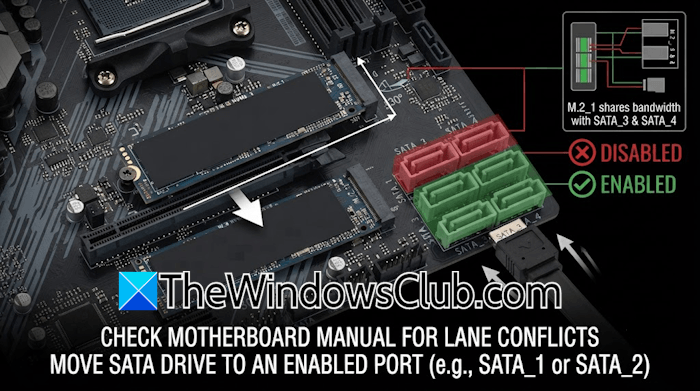

4] Check for SATA and M.2 ports conflict
If the issue persists, check for SATA and M.2 port conflicts. On some motherboards, installing an M.2 SSD disables specific SATA ports. As a result, the computer stops detecting the existing SATA SSD or hard drive. To check this, refer to your motherboard’s user manual and see which SATA ports are disabled when using a particular M.2 slot. Once you find it, connect your SATA SSD or hard drive to a different SATA port that remains unaffected by the M.2 slot.

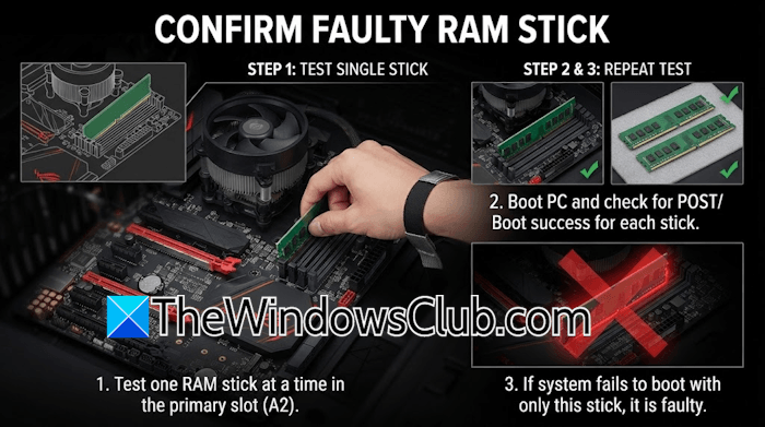

7] Test your RAM
If your system has multiple RAM sticks, one of them might be faulty. To confirm this, turn on your system with only one RAM stick at a time. Repeat this step to test all the RAM sticks. If the computer turns ON with all RAM sticks except one, that RAM stick might be faulty.
