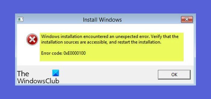

When you encounter this issue. you’ll receive the following full error message-
Windows installation encountered an unexpected error. Verify that the installation sources are accessible, and restart the installation.
The accompanying error code could be 0xc0000005, 0x8007025d, 0x80070001, 0x40003, 0x4002f, 0xE0000100, etc. and it can also appear during Windows Update.
