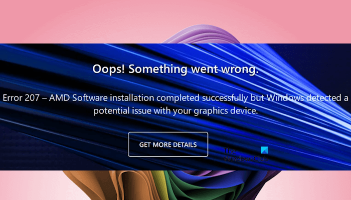

Some users have encountered the Windows detected a potential issue with your graphics device error when they turned on their computers. Due to this error, they experience performance issues on their computers. This error is associated with the AMD graphics. If your computer has AMD graphics and you encounter this error, the solutions provided in this article will help you.
The complete error message is:
Oops! Something went wrong.
Error 207 – AMD Software installation completed successfully but Windows detected a potential issue with your graphics device.
Use the following suggestions to fix the “Windows detected a potential issue with your graphics device” error on your computer with AMD graphics:
- Use the AMD Software Compatibility Tool
- Check the status of the AMD graphics card driver in the Device Manager
- Uninstall and reinstall the AMD Software
- Install another compatible version of your graphics card driver
- Perform the Clean Installation of the graphics card driver
- Perform System Restore
I have explained all these fixes in detail below. Before proceeding, restart your graphics card driver by pressing the Win + Ctrl + Shift + B keys and see if it helps.

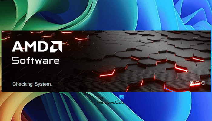

1] Use the AMD Software Compatibility Tool
This error can also occur after the installation of the AMD software on your system. The possible cause in this case is the installation of an incompatible version of the AMD software. You can use the AMD Software Compatibility Tool. This tool is available on the official AMD’s website. Download and run this tool on your system. It will automatically find and install the compatible AMD software for your system.
If the AMD software currently installed on your system is already compatible, this tool will show you the following message:
The version of AMD software currently installed is already a compatible version.
Now, in this case, you need to apply some other fixes.
