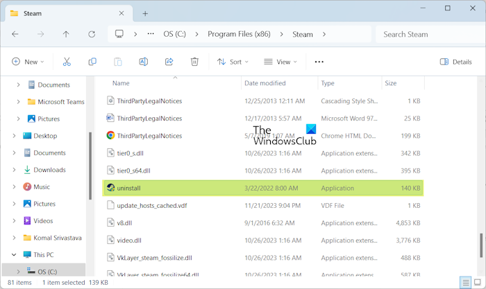

Check the folder where you have installed the application you can’t uninstall. Here’s how:
Open File Explorer using Win+E and navigate to the installation folder of the program. For example, some users reported to be facing this error while uninstalling Steam. In that case, the default installation is C:\Program Files (x86)\Steam, C:\Program Files\Steam, or C:\Program Files\Valve\Steam.
Now, find the uninstall.exe file. If you find it, double-click on the file and proceed with the prompted instructions to complete the uninstallation of the app.
