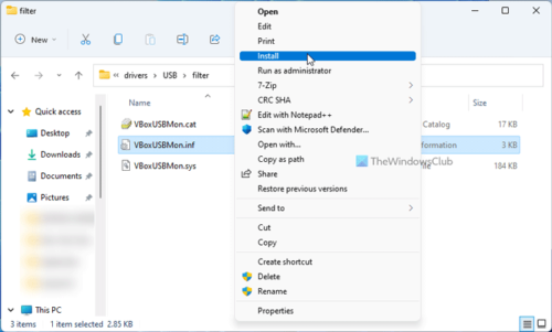

Manually install the VirtualBox USB driver
- Once the computer boots after the completion of the first step above, press the Windows key + E to open File Explorer on your computer.
- Navigate to the directory path below:
C:\Program Files\Oracle\VirtualBox\drivers\USB\filter
- At the location, right-click on the VBoxUSBMon.inf and select the Install option.
- Reboot the computer once the installation completes.

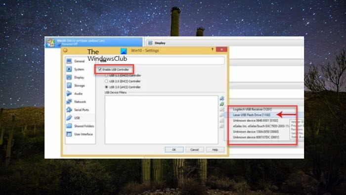

Create a USB filter in the VirtualBox VM settings
USB filters allow you to mount USB devices in VirtualBox VMs automatically. To create or setup or mount a USB filter in the VirtualBox VM settings, do the following:
- Continuing after step 2 above, on boot, if the USB device that’s throwing the error in view is plugged into the computer, unplug it.
- Next, open and close VirtualBox. This action will remove the USB device from the VM’s seized list.
- Now, reconnect the USB device.
- Open VirtualBox and start the virtual machine.
- Right-click on the VM and go to the USB menu.
- Checkmark the USB controller option.
- Click on the “+” sign on the right side of the window to show a list of currently available USB devices.
- Click on the USB device that you want to automatically access inside VirtualBox.
- Click OK to confirm and exit.
From now on, if you plug in the filtered USB device, it will be automatically passed to the VirtualBox guest OS and won’t show up on the host OS.
